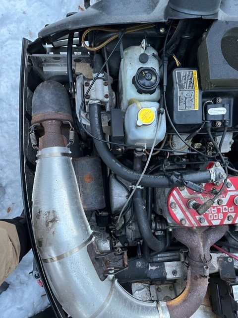

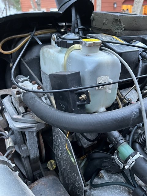

Thank you for the info, that makes things a little clearer for a noob. Just ordered a shop manual. Being a noob in a little unclear what here is the regulator, I was told the black box on coolant reservoir was a CDI? Could you narrow down that location? Also, is it normal for the yellow wire to be there unconnected? Thanks again, DM me a mailing address and I’ll send a gift card to your local watering hole.

Yes, thats the CDI on the reservoir, that controls your ignition timing curve. You shouldn't ever have to touch that box. IIRC that hanging wire is normal, but its been a few years since I've been under the hood of one of these sleds.
What you are looking for is behind the pipe and above the footwell, usually mounted to that aluminum piece above your foot. I can't make it out in that picture but should look like below....
Also don't buy an aftermarket or used one, have to suck it up and pay Polaris on this one. The aftermarket ones do not last long at all from what I've seen.
I would also disconnect the negative battery cable while doing this testing to make sure the batterys not putting a strain on the charging system at this point.
