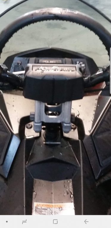

Hey guys/gals, new member here so first off, hello from NH, secondly I have a 16 rmk 600 144 with the "new" style bar setup. A buddy of mine has a 14 sba 144 with the pro taper setup, I'd like to swap my setup for that but mine has the T post vs the clamp style. Anyone ever swapped the upper stem on a 16? Does anybody know what sled has a compatible stem? I did some research and found that there are a few options for the clamp style but not sure if it's the length, diameter or what the deal is. Any insight much appreciated.
I know a while back I saw some aftermarket companies made conversion blocks.Try rox or powermadd.
