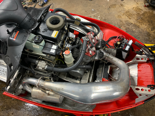

So i picked up this very clean 02 600
Engine rebuilt about 500 miles ago. Has an aftermarket pipe.
I did clean out carbs.
On idle it backfires. Is this because of the pipes? Or Carb issue??

Looks like a SLP pipe, I would get a hold of their jetting info for that sled and check that its correct.

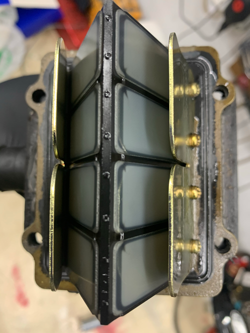

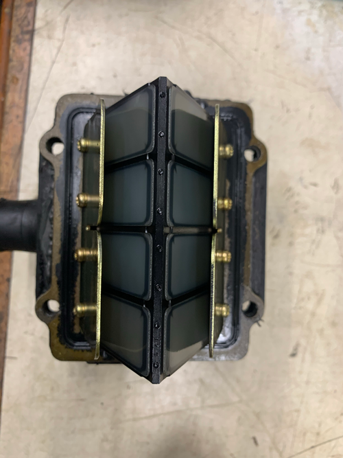

could it be reeds?
Thats not going to help your problem, the main jet is barely active at idle. You need the needle settings as well as the fuel screw since this all involves the low speed circuit.
Reeds is a possibility, is it spitting back alot into the airbox?

Reeds are spotless see pics.
QUESTION: im thinking of REPLACING, not just cleaning all the jets and screws in carb-- can someone help me find correct kit on ebay or amazon??? do i really need ALL the gaskets and O rings, or can i just swap all jets. carbs are spotless (whole machine is actually) see pics.
