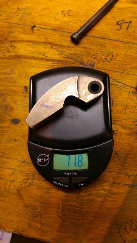

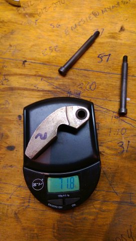

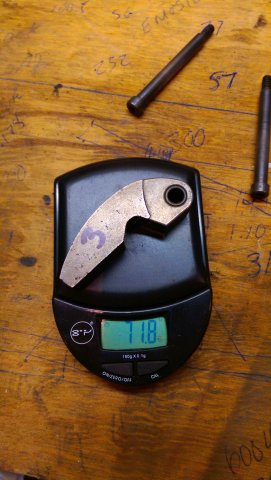

10 series weights
From factory.
Matched

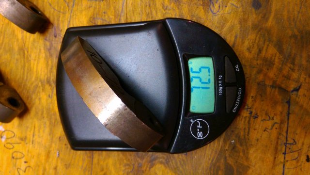

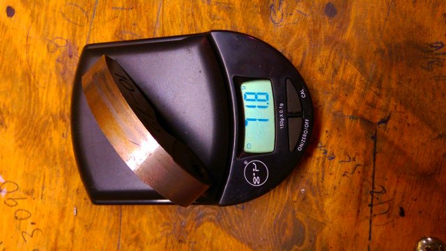

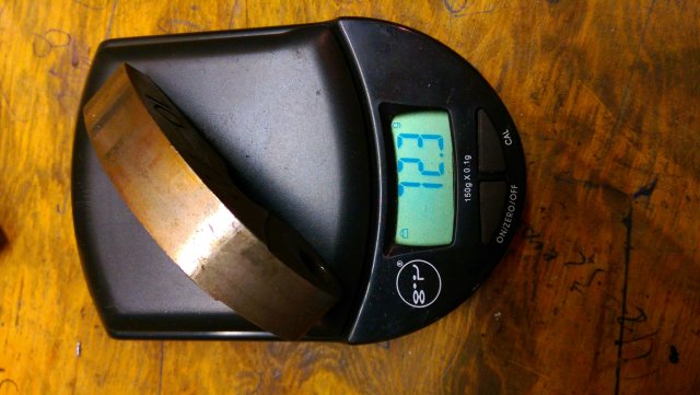

Its crazy how much they can differ even on aftermarket adjustables i found the same thing
Yes it is
That's why I make sure everything is equally balanced and measured properly. OEM specs have to much variances and tolerances for me.
