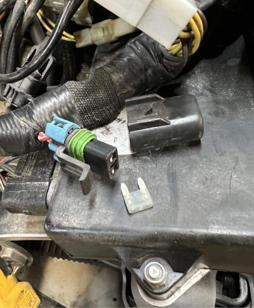

850, I found it!
It was right there above the cdi box. 2A mini fuse. My visor wire was damaged and must have shorted. The fuse is blown. Will grab a couple spares and tape them to the harness for future.
