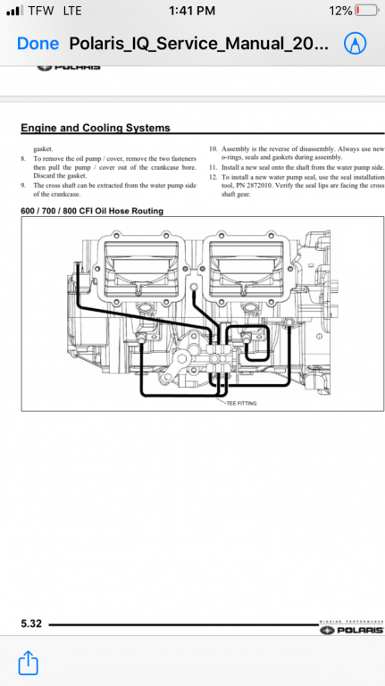

So been rebuild a sled I bought blown up ordered a new oil pump online it says it has only five out puts mine has 6 two are t together. Contacted Polaris and they ran my vin and said I’m incorrect my pump has and should have only 5 outputs. They tell me two bring the snowmobile to a Polaris shop for more assistance. Can I just remove the t and run the new pump?
