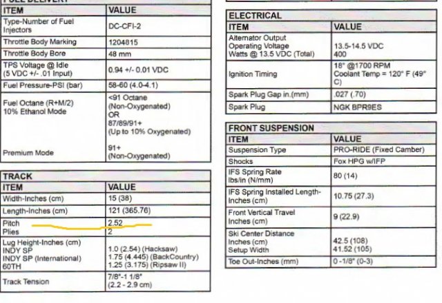

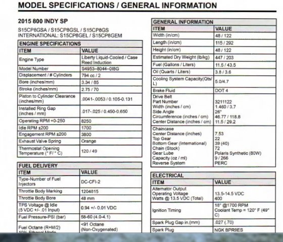

I know I should know the answer to this question but hey I'll ask anyways.
What pitch Drivers are on the 2015 INDY 800 and where would I find this info for Polaris Sleds?
2.52
Thanks RacerDave. I was thinking it would be in there but didn't know where I could access that Info online!
