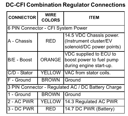

Sounds like its possibly the regulator since that sends a voltage boost to fire the pump on startup, see B/E below. The little bit the sled was running showed no voltage at the pump still?

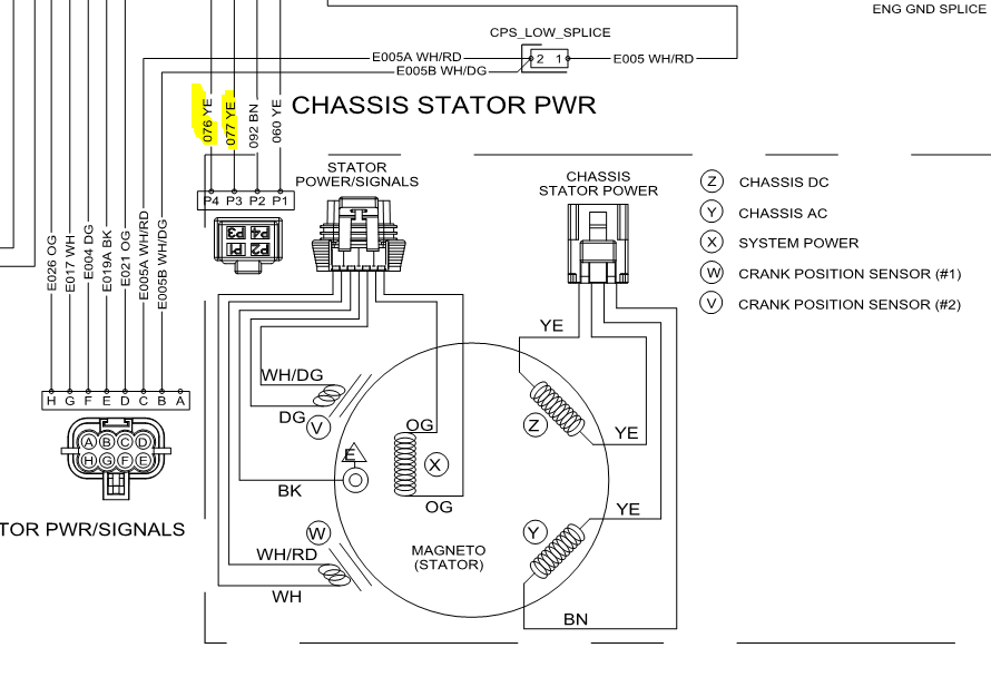

There are 3 separate loops off the stator that run independent of each other, this is setup so it can run battery less. In your case the battery is just there as an accessory to run the ES, its only ties to the sled 12vDC for re-charging. The headlights are on a independent AC loop & coil off the stator, thats why they begin seeing voltage only when you crank. The ECU voltage is provided by the 3rd stator loop I described above.
So its possible you cooked one part of the stator and the other 2 are still functional.

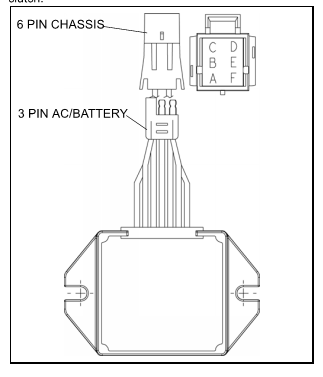

The voltage off the stator is AC, make sure you changed the meter, and should be 14v across terminals C/D below. It should also have roughly 0.20 OHMS resistance across it.
I would also check the 4 pin plug directly off the stator with the 3 yellows and 1 brown wire. That is part of the feed to this regulator.
Unfortuately they don't give much more than what I've posted. I'm guessing the ECU wont do anything until it sees the B/E boost voltage from here, thats why it wouldn't fire the injectors even after you primed the system manually.
If you want to check directly at the stator, its wires 76 &77 in the 4 pin I highlighted below that feed the regulator
850 thanks for the help. It was the stator. Your diagrams were help full .
