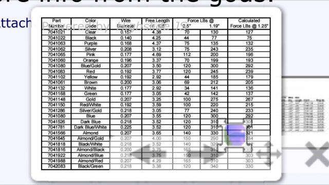

Has it always bogged or did it start doing it recently? I've had 2 500efi's and they both bogged off idle a bit. I installed a higher engagement spring in the primary and it solved the bogging issue on both of them.
Found this this morning,I'll be switching springs on Sunday and see if that helps.
Actually that's one thing I had on.my list for you was all the polaris primary spring specs.
