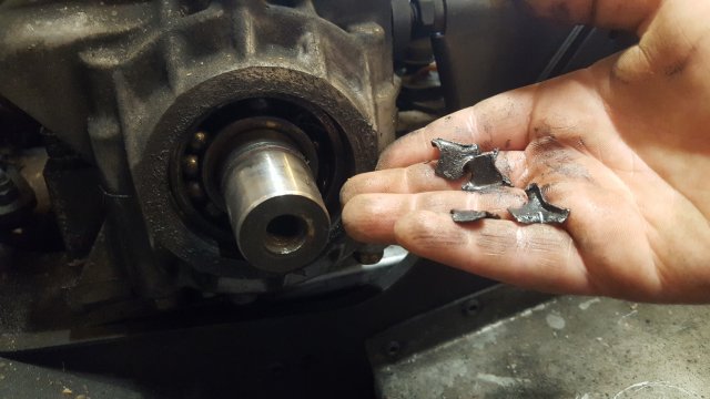

Which company do you guys recommend for crank work? I would also consider a good used crank or complete engine, as I have not been in to see what else is trashed.

OK...I made a call to Northern Crankshaft in MN. The gentleman I spoke with was very knowledgeable and up front. Worst case scenario; the crank needed ALL bearings replaced, it would be about $500 to rebuild. I think 19 years and 7,000 miles would dictate a complete bearing replacement IMO. The cylinders look good, but no doubt have some wear, so I think a .20 overbore would be in order as well.
Long story short...
Pistons + overbore + crank = $1,000
Personally, I don't think that's bad. The sled is same as mint condition for the age and you can't buy much of a sled for a grand these days. However, I have way too many sleds and I'm having a hard time justifying ten $100 bills for repair.
