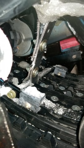

We pulled front limiter strap on all sleds so when rider is on it it was snug. Did this to all three assaults. Drilled extra holes one inch apart too(trail change). All limiter straps were the same length. It ended up being ,so the ends of limiter straps were over lapping 1/4-1/2" Fts was all at one inch(helps attack angle)

So, to wrap this story up. Lower front ifs by using pro s springs, have limiter strap so there's one inch gap between two ends(studs only), fts at 1", rear torsion on soft.

this is a pic of limiter strap were we have them now with studs. About 7/8"-1" apart at ends. And yes, all 3 straps were the same length.
