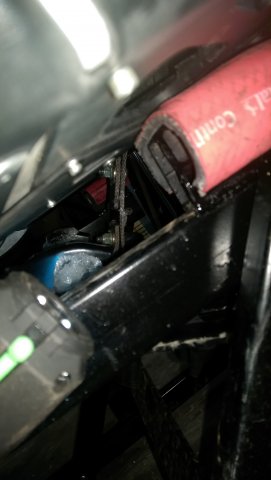

If you're studded only. Pull limiter strap so both ends are about 1" apart.
This stops some of the transfer on assault from being a wheelie machine and a better hole shot machine.
This stops some of the transfer on assault from being a wheelie machine and a better hole shot machine.View attachment 1891
