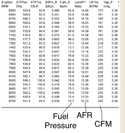

What is cfm? The fuel pressure is on there just not graphed. Is this with there top end kit also or stock pistons?

CFM refers to cubic feet per minute. It's the amount of air consumed in that time.

This is a Dyno run showing what I wanna see above
This run is very safe in bsfc and afr
Good for the every day trail rider
As in : The Air/Fuel ratio could be set to "Top end is toast in 200 miles?"
Yeah, I'm always skeptical of a dyno run brought to you by the seller. Not saying this is the case here, but you can get a dyno to say basically anything you want.
Bsfc- .500
Afr-13
Good thing its not boosted.. 11.8 to 12.2 would be max boosted. Those are some lean AFRs for a boosted sled in the upper RPMs on that chart. Running that lean on a boosted sled creates a ton of heat and that would be the death of that motor on a long pull on a rail grade in the U.P. of Michigan.
2 stroke to 4 stroke is way different in readings for sure
Turbos 2stroke and that’s another game for sure.
Doc did well on his that I heard .
