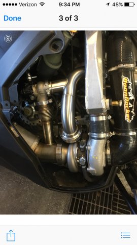

I just have pictures, of you would like you could join me when I go back up there to hang out. Always interested in meeting fellow Polaris owners
This is what I have at present time, muffler will be changed and most likely the turbo too
