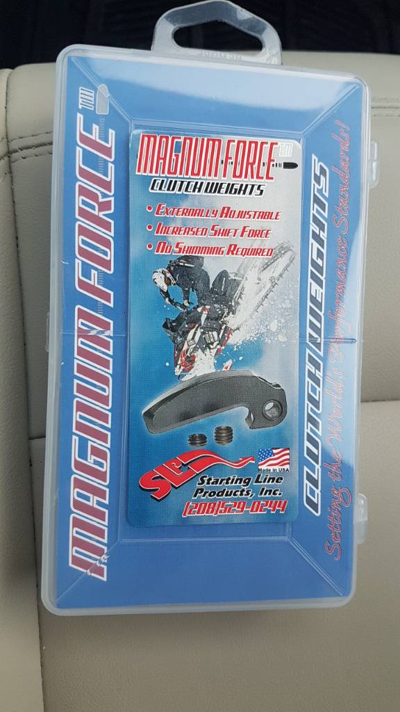

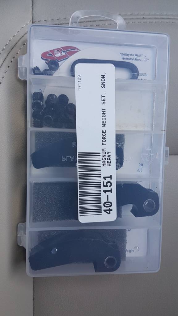

Get these.

Get these.

I agree, those weights are a good choice. SLP has great customer service as well. Easy to adjust and only need a few springs to make them work.
Use less weight then you think. These work heavier. If you norm use 68 try 66 first etc

You will need to run more primary spring with these weights. 140/330team, 160/340slp, 165/327team are all good.
