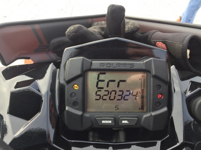

Finally got to take my 2016 pro s 800 out to break her in ! I'm up in Greenville me and first 300 miles where pretty good ! But coming back last night a check engine light is showing up now stays on until I go full throttle then it will shut off for a minute then reappear ?? I am going to try to pull codes in a hr or so any ideas has this happened to anyone else ??? Also didnt want to go past 70 mph after light comes on ! I assume that's some sort of limp mode

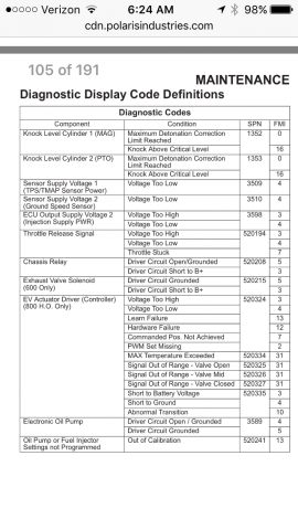

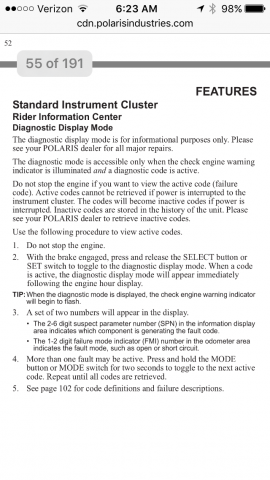

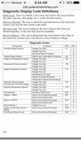

I got these from manual
Voltage Too High
520324
Voltage Too Low
Learn Failure
Hardware Failure
Commanded Pos. Not Achieved
PWM Set Missing
MAX Temperature Exceeded
520334
Signal Out of Range - Valve Open
520325
Should I reset it and see if codes come back ?? And how are codes reset :)
Well had it at dealer he pulled 1401 and 1407 and reset the computer all voltages were good so I took it home and tried it !!! Ten minutes later same codes came up :( so back at dealer today to have it looked at again not cool 400 miles and sled is in shop pos
