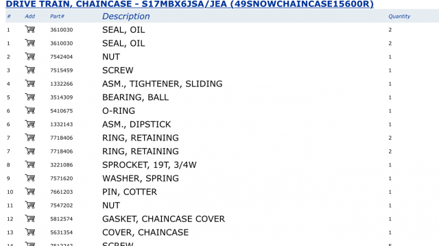

Can you share a part number for the AIR roller? Sending my track shocks out for valving this year. Also, considering changing to the cobra 1.3 track as it seems to hook up better in the loose trail conditions that we ride in mostly. Worth the trouble and cash to make the change? The rip 2 does awesome on hero snow/trails but honestly thats maybe 10-15% of my riding, lol...

You can get that IQR tensioner from any Polaris dealer. I bought them from Babbitts. $45.19 there this morning. Ronnies mail order, $50.84 there as of this morning. Free shipping if you spend over $99 at Ronnies.
