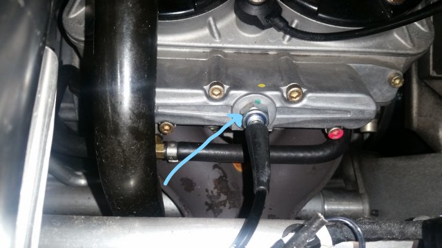

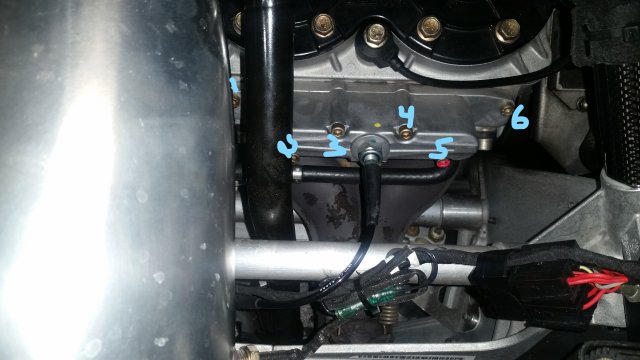

Is it necessary to remove the actuator? Can I simply unbolt the cable from the engine block itself(first picture) or do I need to remove cable from actuator(second Picture)? Its just the 6 bolts, right?

OK, I guess i'll just remove the bolts and find out myself. they look like the correct ones but thought I would get someone who has actually done it to verify it first.
Just remove cable from actuator , then the valves from the motor don't touch the valve travel

So you are simply removing the 6 bolts and pulling the valves and dropping in the bucket?
I use a carb cleaner solvent.
Yes , removing the valves dropping in bucket in belly pan , let it sit 24 hours. , scrub as needed with purple scotch brite and a razor scraper . Wipe clean, blow off with air and re install .

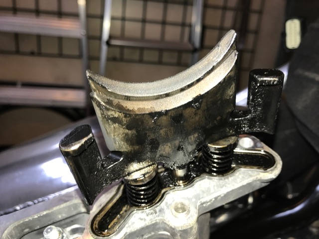

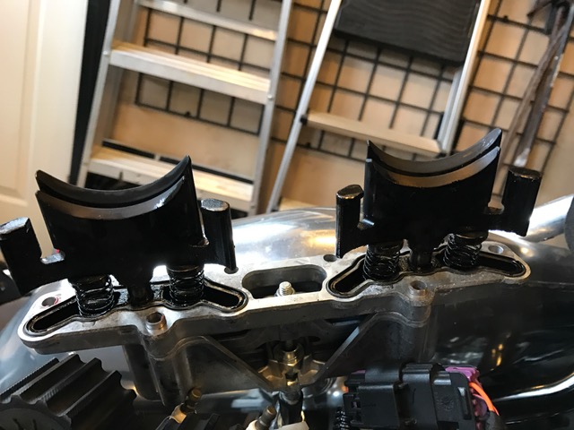

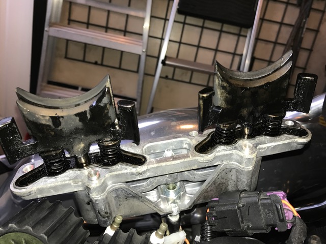

I removed the power valve assembly from my 2015 SB Saturday, I left the pipe on and everything, just removed the 6 bolts holding the assembly then pulled it out - came out pretty easily. I didn't disconnect any cables or anything.
I used oven cleaner and some carb cleaner, then a sharp blade and green scotchbrite pad to clean them up.
Pictures are prior to cleaning....
