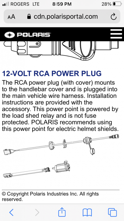

From what I can see there is no fuse ...

Yep, sounds like your fuse. I believe it is a 2 amp mini fuse. It is located in that velcro "pouch" at the bottom left of the oil tank reservoir on top of the clutch shield.
