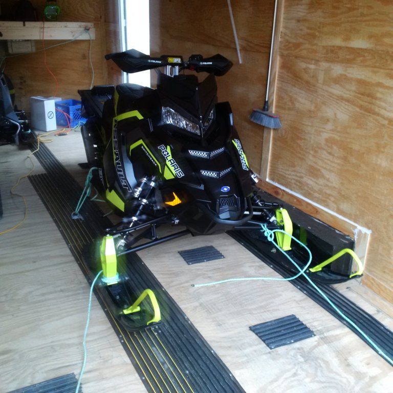

Hey guys, just brought my new sba 800 home today and just playing around with all the switches and I've notice that I have no highbeam or hand and thumb warmers when I start my sled but after I let it warm up a bit and get it a little gas it works, does this sled have a power limit below so much rpm of the motor??
Nice rig. Yes the handwarmers and high beams are disabled at idle so the circuits maintain enough current for things like the electronic oil pump and so on. Totally normal.
