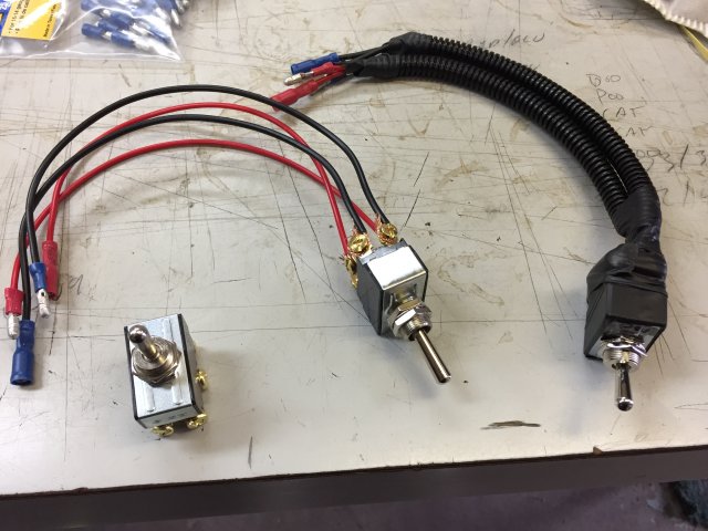

made these awhile back and never had a chance to Dyno test with a stock 800 axys . Jim at dtr has one on Thursday. It's to get proper pipe heat that we never see on trail/racing , etc
I'll let everyone know how it goes

It's to fool ecu into optimal pipe temp . This in turn gives more timing .
Pipe heat is key and since Polaris has its optimum temp so high , it's almost impossible to get while trail riding or racing . Cat and doo use a lower pipe temp vs Polaris.
I made the switch to go from stock to hot .
We've done this before with success ( cat guys use it in racing). We will see if it works or not Thursday?? It depends on ecu ??
Jim at dtr is ready to test this

Switch didn't work good . The ecu didn't like it . Made it go pig fat from about 7500 -8500 rpm
Oh well, it was worth a try as it works on cats. But the cat ecu isn't as sophisticated as the Polaris .
The pipe bung does work though , raised temps 100+
I was told not to do that
Moving the exhaust probe bung did work on Dyno though . Like I said , it got pipe heat up 100+ degrees.

Yes, that's not quite what I'm trying to do though . Jim at dtr helped develop those way back and I'm testing there so it's great that way .
It's just the desired exhaust temps are never achieved with actual.
Many ways to do it . Going to try more stuff that's inexpensive. That's why I'm doing this . So guys don't have to buy an expensive controller.

Is this switch like slp pipe temp resistor? Trying to fool the ecu in to thinking pipe is cooler or hotter to make sled run leaner or richer? I have heard there are 30+ different maps in the ecu controlling stuff. Seems the best way to make pipe heat is the internal stinger pipes like ssi, bmp, straightline mountain version.
