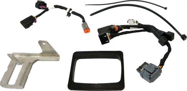

I just picked up a used Switchback, which had the IDD installed by the dealer, the seller removed it and put the original cluster back. so I need the instructions to re-install the IDD. Anyone have or know where I can get the instructions?
This is the kit.
Thanks Jet
Would really like to know where the GPS mounts, and where that orange plug connects. I installed the gauge, but don't know about the GPS itself.
Rob, this is the GPS antenna on a AXYS. Not sure if that is what you are asking or not.
The grey/orange may plug into the bottom of the antenna? Just a guess.
May just be a extra plug for other use's?
It's fused so I would really like to know don't want to burn out the IDD, which by the way shows 8467 miles from the machine it came from. Ugh, that's not gonna help resale.

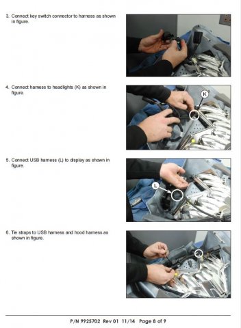

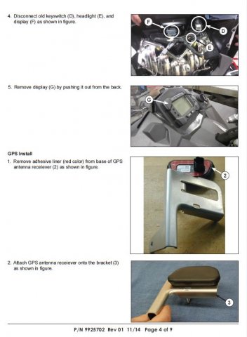

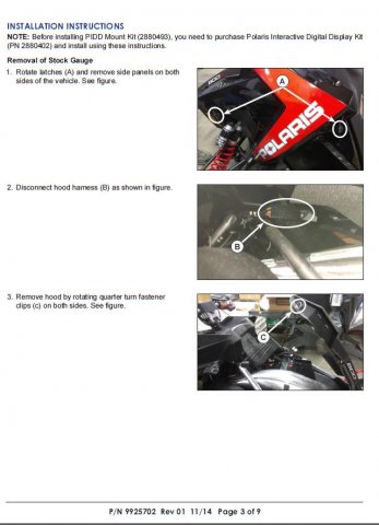

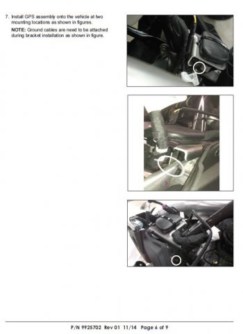

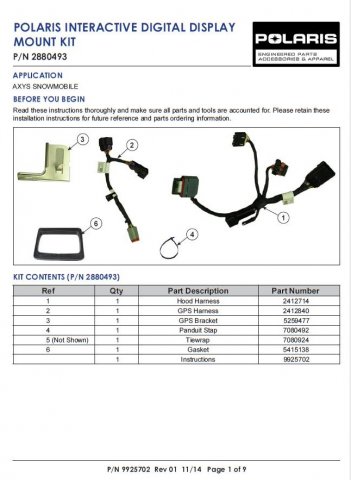

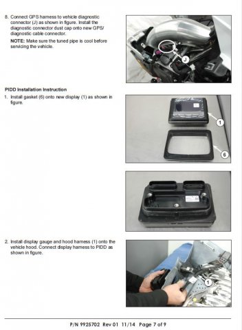

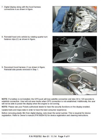

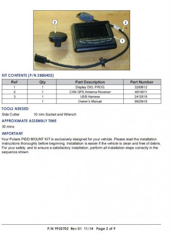

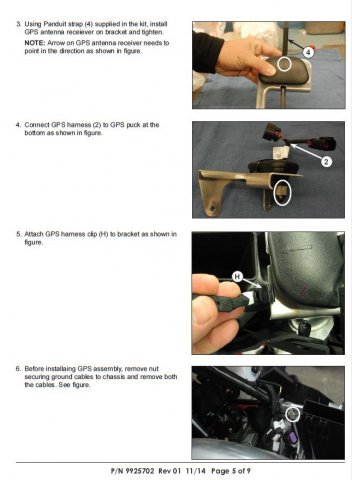

IDD Mount Kit Instructions
Thank you!!!
You definitely went the extra mile getting this. Ironically my "extra" cable is not mentioned so I am guessing it is just that, and extra.
Now I can sleep not worrying what hidden damage I might be causing.
