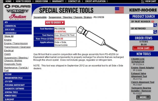

A friend of mine is northstarrick. He's here in NH & he does all the work on my sleds/wheelers. He rebuilt the rear track shock but couldn't rebuild the others because he didn't have needle long enough to recharge the others. Mine is the first Indy he's had. He gets all Rushes/Switchbacks and other makes. But no Indys. Also, he said the front track shock was leaking. I beefed up the suspension a bunch & was trying to get these all rebuilt.
This might be the longer needle?
Ouch!!!!
$148 for a fill needle?
Spendy.
