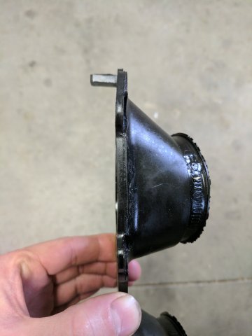

Well I figured it out. I am embarrassed to say that I didn't notice the throttle body boot had a good sized dent in it on the pto side. I checked the outside thoroughly but never looked at the inside. At least I didn't have to tear it down!
Here is a pic of the boot. I can't believe I didn't notice it. Held it up to the light, blew it off with air and shot it with WD 40 before putting it on and never saw the dent.

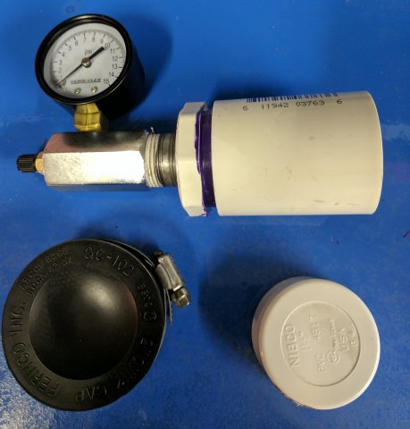

This is how I found it before taking it apart. About $20 from home depot for everything. I will never finish dressing an engine without pressure testing it again!
