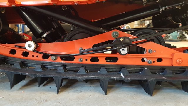

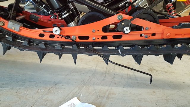

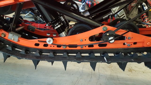

Customer wanted these ones on. Theres no room without removing front wheels. There is wheels inside rails not far. So i dont think it matters that much removing outside.

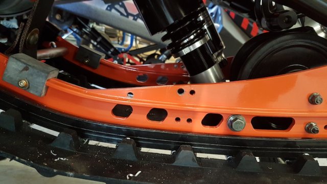

Theres 2 sets of wheel mount holes
I drilled the front hole bigger for spring mount. Use the back hole instead if your going to use these style scratchers. so the hook is farther from spring during full compression when its hooked on rail.
Possibly make a bracket to hold the end outside the rail instead of hooking it on top of the rail.
