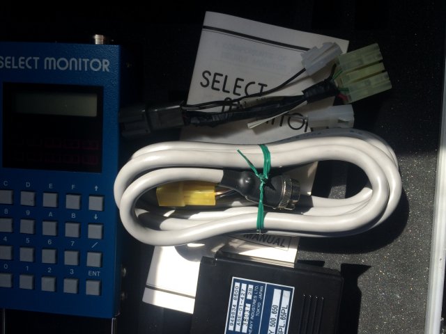

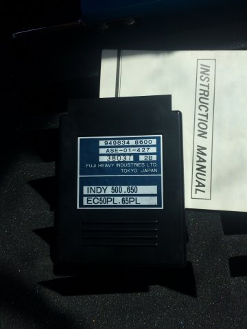

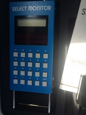

I know this is for older sleds but I just got a brand new select monitor for both the 650rxl and the 500 efi's for what I would have spent on a laptop and cable for the free pc version. this is going to make life so much easier!
Can you take some pics of it?
Here it is,never been used:) depending on when I get home I'll be playing,i mean using it tonite
Hooked it worked as it should, found out idle fuel adjustment is supposed to be between 2 and 3 volts,I'm at 4.52 idle spec is 2.7 degrees, I'm at 3 not to far out. Tried making a short video,I didn't like it,as I tinker I will keep you guys posted.
