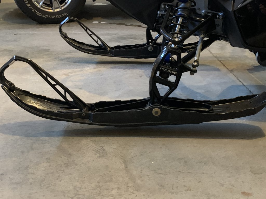

Hey all ... so it's been a long time since I've posted here (sorry). I have a new VR1 at home (it's the 850 with the 137" track). I spent some time tinkering around with my sled a couple weekends ago, and noticed the front skis were the worse I've ever seen them from the factory ... from a standpoint of the tips "sagging" forward. I would highly encourage everyone look and shim accordingly.

Look how much the tips come up eh, that's wild. I should do mine.

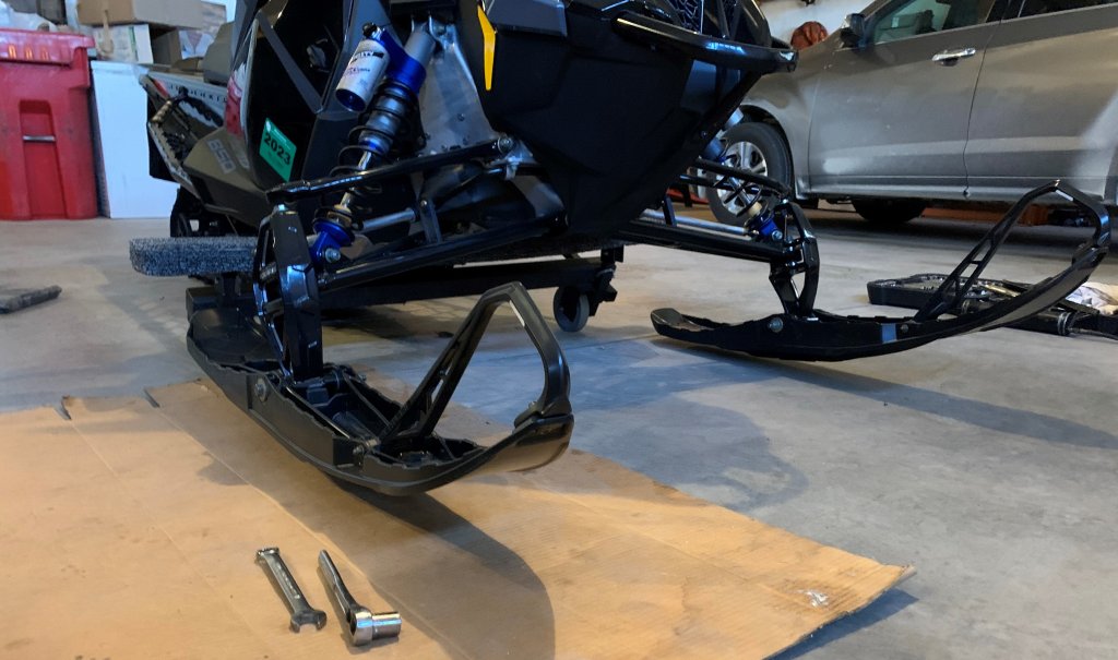

We shimmed my buddy's new VR1 this morning, with the Bergstrom shims. I don't know what changed, but holy crap ... we were able to get the skis on and the bolt through without a ton of effort. And if anyone has installed these in the past, you know what I mean - there used to be some serious pushing, pulling, putting the side of the skis on a 4x4 block of wood, ranking on the ski ... you name it. I think the only time I swore was when the bushing fell out while I was trying to put the ski back into place. In the past, I was swearing like a sailor!! LOL
