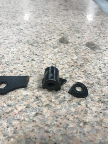

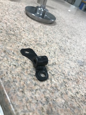

2015 800 axys 120my tourque arm broke and they are a known issue..i love SLP products and the tourque arm works good..any replacement ideas until they get new ones in?..thanks
I made one to bolt on to frame like the old xcr 800 triples..works perfect
Just curious were did it break at ?
it broke in three places around the weld on the bracket bolted to engine block..i will get a pic of my new one..
Here is a picture of that broke first day of riding. Having it 3D scanned and making a new from a tough tool steel 1-piece design.

Seems like the es torque strap models need to be rethought??
No problems with pull start torque arms that I've seen
Geez, I can hear it now. "Who the f needs e start anyway."
Bottom line is?
It's best with a engine torque stop pushing, not pulling .
