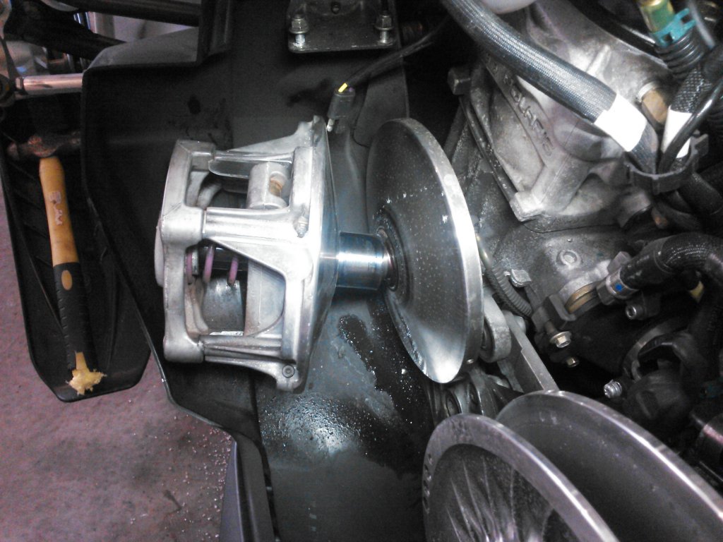

Had this happen on my 12 pro-r... It was broke for sometime.
Wow. That happen pulling it or ?
Ya I cracked my bulkhead so I needed to remove the motor. Motormount hides behind clutch. Put puller in and this happened. Just with a ratchet. Glad it didn't come loose at 8300 rpms... I knocked the rest off with a hammer and took a cutoff wheel and sliced a piece of pie out of inner sheeve and removed motor mount.... To bad I had already cashed the insurance check....
