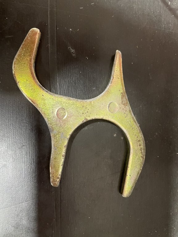

Just so I don’t break or strip anything. How do I get the transfer blocks to turn? The owners manual doesn’t give adjustment instructions... it just says there is a tool needed that is ‘available at your dealer’.
Usually you can turn them with your fingers, when new they can be a little tighter then can use channel locks or crescent wrench.
Or use the old double u shaped tool Polaris used to include with XTRA 10 and forward sleds
