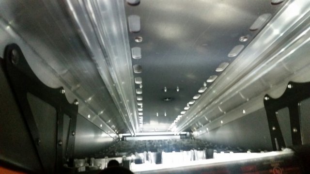

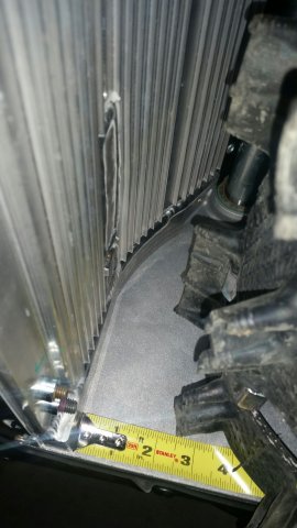

    I'm not adding any extra. Have the Cobra track and using Woody's 1.450" in the center only. Looks like plenty of clearance. The track lugs will hit the protectors that are on the coolers before the studs hit the tunnel.

    Remember the track can tend to balloon out a little more in the center.
