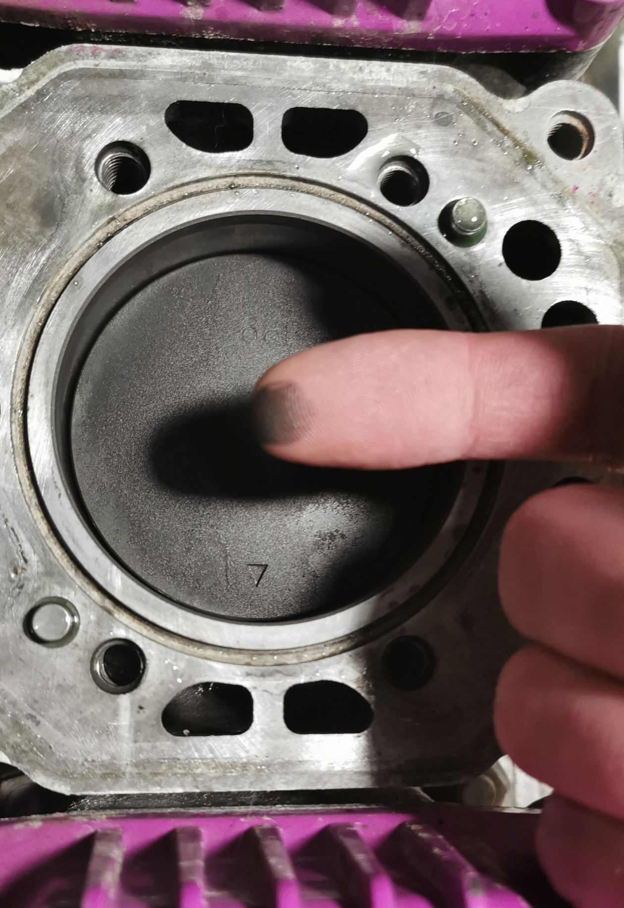

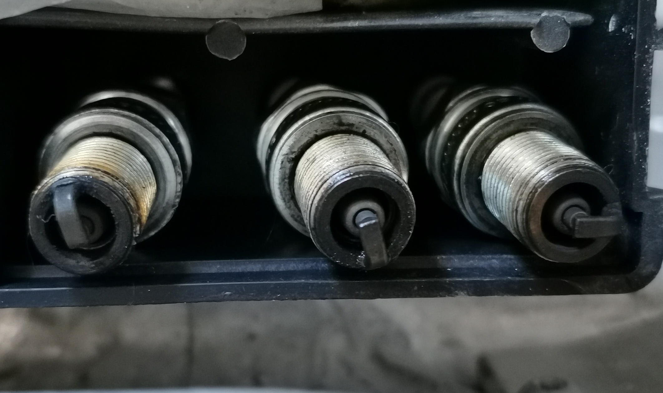

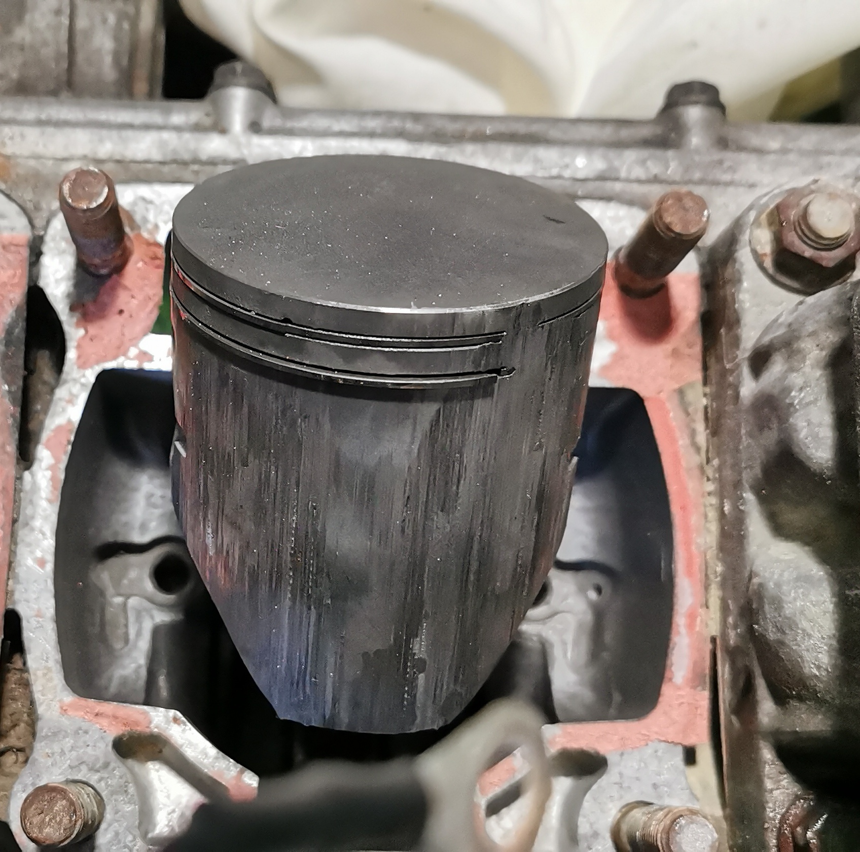

I have a 1998 Ultra Touring and blew the center piston the other day, it was running totally fine for an hour, about -15 celcius, on a groomed trail, the machine had a fair amount of white bluish tinged smoke when idling, The oil light flashed on for a min. rode for about 30 miles stopping occ, cruising at 40-50 mph and bogged out, the oil light flashed on a couple times, started it and went for 1/4 mile, same thing one more time, then trailered it home, when loaded on trailer started to hear a ticking. the carbs were cleaned at beginning of season, needle jets at stock, always idled smooth. removed top end, water pump ok, center piston scored, outside 2 totally fine, wrist pin seized in piston sleeve, not bearings. attached are pics of center piston and plugs, did it run lean? antifreeze leak? any ideas would be appreciated, ask if you need more info, Thx

I would be looking at the oiling of that center cylinder to see what happened. Something get plugged in the lines to that cylinder?
I had the same thing a few years back. At -15c ice had formed in float bowl of center carb and leaned out that cylinder.
It only takes a few ice balls to form to lean out main jet.
Check your fuel by placing it in a clear glass container and look for separation.
Thx for the info, Has anyone heard of a coolant leak causing this? cylinder gasket maybe? Water pump checked out fine. I will be checking the carbs this wknd. Would the piston look like that with it running lean? there was lots of carbon on top
