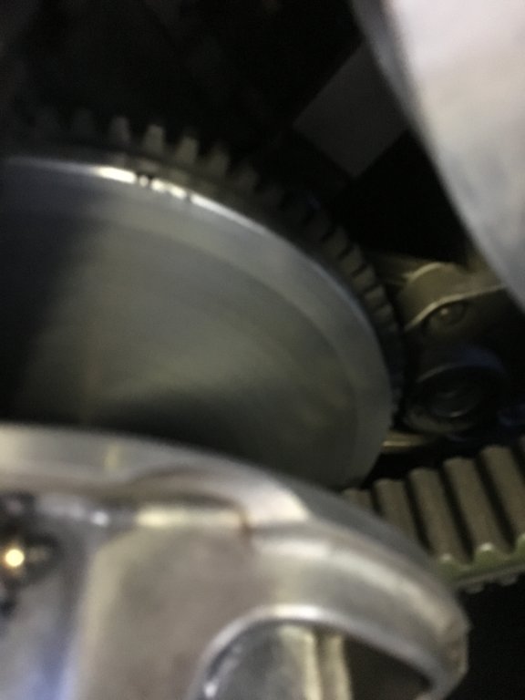

Ok update... tried a few setup changes as asked. Pulled resistor, run fresh 91 shell non eth on that tune. Pulls 8150 initial then climbs to 8250-8350. This is with 1.74 gearing still. Ran 100 on gauge 93.8 gps on hilly straight trail ( not ideal) clutched and set up 06 apex attack ran 100 gps on same place same pull ( Not the supercharged one ). axys pulled harder up to 70 for sure. Feeling better. Is the gearing causing the initial lower rpm then climb to peak? Or would the daulton weights and springs suggested help that. I added a pic of clutch mark to show him much the belt is rising

The belt is not reaching the top of primary by picture shown. At least 5-10 mph there.
I don’t know you’re current set up that made it better? But I’m glad you’re going in the right direction. Looks like tip weight and a lower finish secondary spring might force belt up top along with 1.81 ratio
