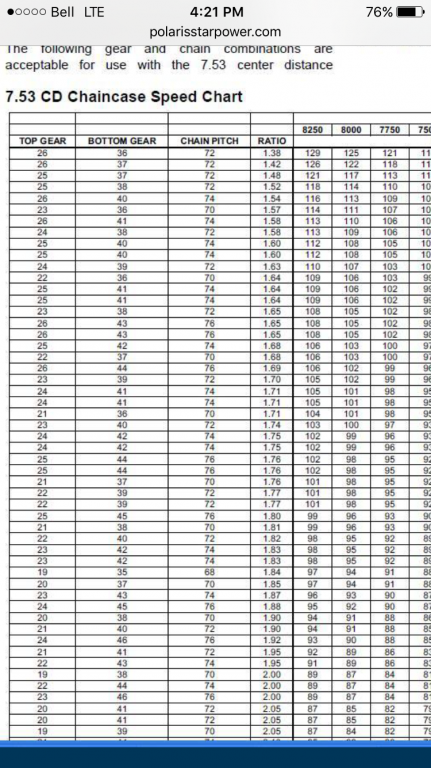

Anyone have this to see chain slack per gear's/chain pitch used? It is different than the AXYS chart.
Haven’t seen this post before now Dave... are you looking for the gear/chain combo chart?
No, I was looking for the gears/chain combos that shows the chain slack/bend.
