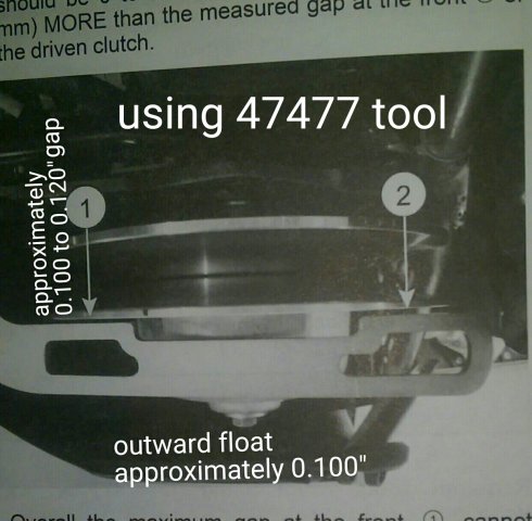

As I've seen on many 800 HO axys sled's. The clutch alignment from factory is a broad range.
Using a 47477 alignment tool.
Place in primary and let rest, the gap between the front of 47477 tool and secondary needs to be 0.100" to 0.120".
After this, let secondary float out at least 0.100" and more.
I like inward and outward float at least 0.100"as the secondary will find it's way through engagement to full throttle. Outward secondary movement(float) is needed for engagement for primary and secondary to be parallel.Inward movement(float) is for primary and secondary to be parallel under full throttle.
So many clutches are misaligned and losing performance due to heat and belt residue because of heat. Belt residue causes belt slippage along with heat. This can cause lose of RPM and inconsistent RPM .
Hope this helps :)

My clutches are adjusted as per what Brock said and I can hold my hand on either clutch after a few long hard runs til I get frostbite.
If you had to make a compromise, maybe you didn't have enough shims or not the correct ones, but is it better for the secondary to have more or less space between the alignment tool and clutch sheaves?
Thanks Brock, This will help out a lot of members.
To properly achieve clutch alignment as I posted some new washers in behind secondary and for bolt on front of secondary may need to be purchased. Polaris makes washers in behind secondary, and out front(bolt holding secondary)
Sizes, 0.040" , 0.060" , 0.080" , 0.100" , 0.120"
The space between the tool and secondary is when full shift out is occurring. The motor slightly twists to rear and back under load, so the belt needs to be parallel . This is why inward float is needed.
Outward float is only needed for engagement.
In racing, we let it float a 1/4".
The secondary will find it's happy spot.:)

Looks like I'll be purchasing that alignment tool because I can betcha dollars to donuts that my dealer won't have the tool.
My dealer got the alignment tool for the AXYS almost at the end of the season.
Seems dealers just received these alignment tools late in the season. Not their fault.
This is why I posted using the older 47477 alignment tool. It can be used as well. :)
