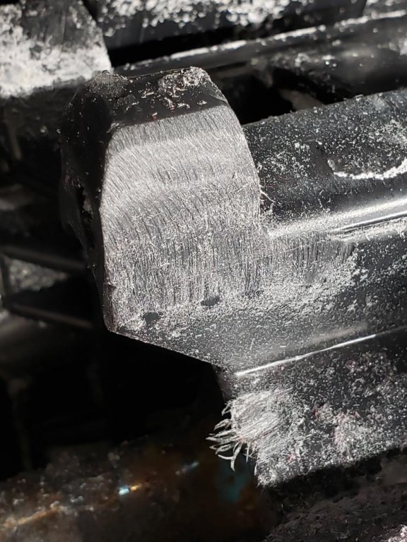

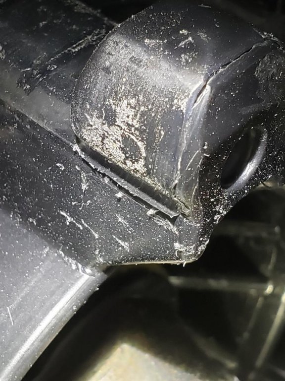

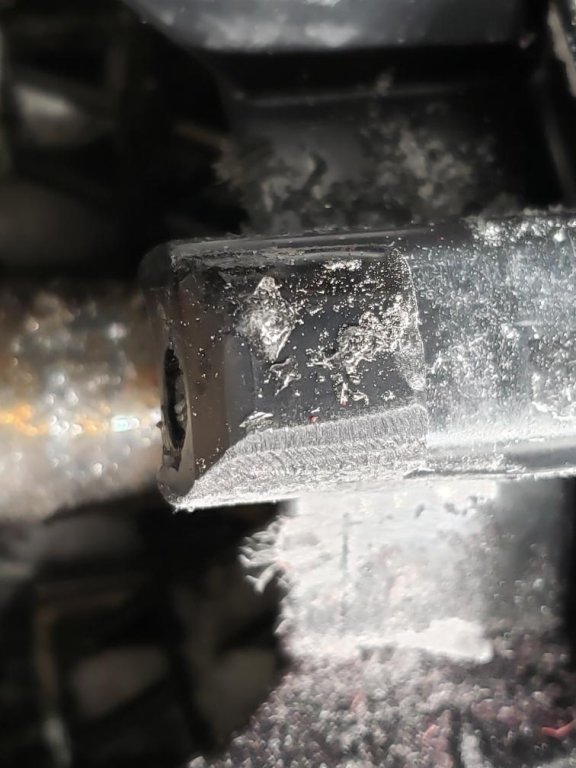

Hello I have a 2018 titan and was having the drone and vibration. Today I solved the issue on my titan. I suspended my sled 4 ft off the ground. Removed the belt and spun the track and examined the track system. I found that the driver that goes threw the track window was not entering the window smoothly. It was colliding with the track clip causing major noise and vibration. So I took my 90 degree die grinder with a grinding disc and reshaped the driver. until it engaged the track smoothly. After getting them all reshaped. I took it for a ride and I would say 98 percent of the noise and vibration was gone. I know that wide track make some noise, but now the noise is what I believe it should sound like. I also am running my track looser then polaris specs.
