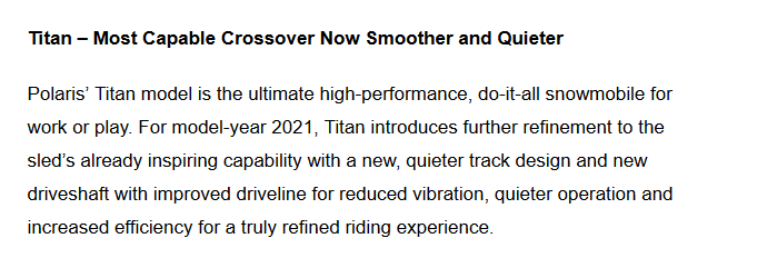

My 2019 Titan Adventure is in the dealership for electrical issues (sensor fault P0128, posted here on the forums). I accidentally discovered this thread about track noise while searching for Titan Adventure fault codes. Since I am new to snowmobiles, when i first took the sled out, I figured the loud drone was just how a big sled sounded. Since other Titan owners are complaining about the same issue, and even worse, finding out that there are bent or broken drives being reported, I asked the mechanic to see if he noticed any loud drone in the track when he test drove it. He test drove it and came back and reported to me he noticed a loud drone and a vibration, but blamed it on the low snow bogeys that were just installed. I have never ridden the machine with low snow bogeys, the noise was there before they were installed by the dealer. Today I find out that for 2021, Polaris has changed the track and drive shaft for the Titan. I am concerned that I have purchased a defective wide track design.

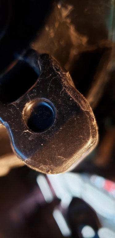

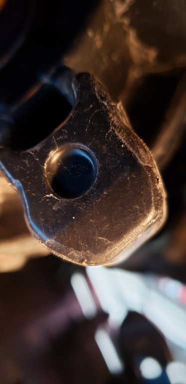

Good job on trouble shooting the vibration issue with the Titan Stan. I was looking closely at my front drive today. Polaris changed it last year in an attempt to correct the vibration issue and to answer Mack's question if it helped, the answer is no. So I put 2000 miles on this new front drive this winter. It is obvious where the vibration is coming from. I will try to attach a couple pics after this post to show what I found. Basically the drive side of the external driver is grinding against the drive side of the track window. This friction is causing the vibration and probably a lot of track noise.

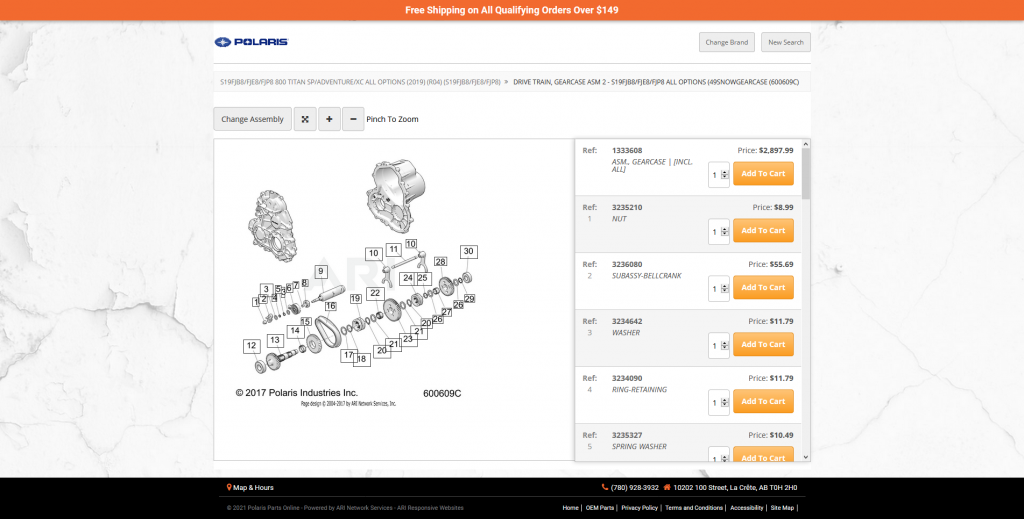

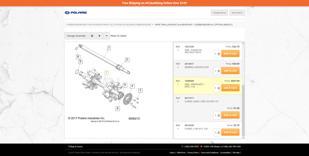

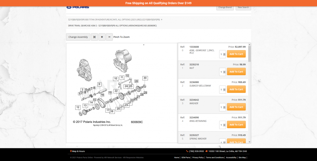

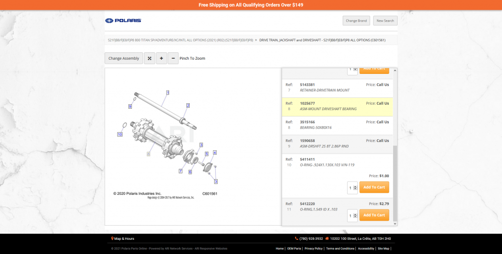

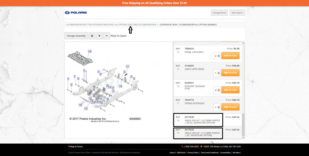

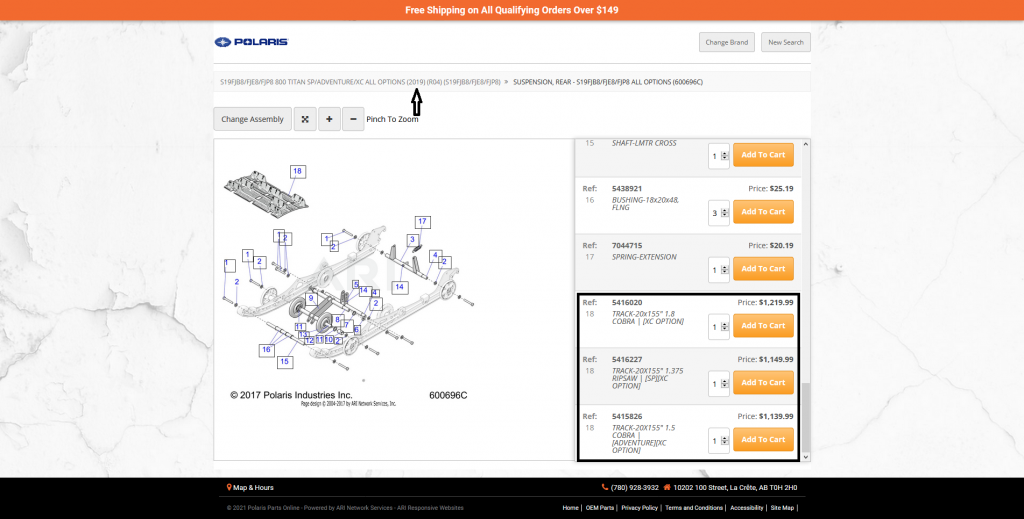

2019 and 2021 track drives for the Titan Adventures. Big difference. Gearbox's have the same part number according to this parts catalogue. I'm looking for the 2021 track part number to compare to 2019's Screenshot_2021-01-19 OEM Parts Polaris Parts Online La Crête, AB (780) 928-3932(3).png Screenshot_2021-01-19 OEM Parts Polaris Parts Online La Crête, AB (780) 928-3932(1).png Screenshot_2021-01-19 OEM Parts Polaris Parts Online La Crête, AB (780) 928-3932(6).png Screenshot_2021-01-19 OEM Parts Polaris Parts Online La Crête, AB (780) 928-3932(5).png
  • 2018-2020 Titan tracks are the same. 2021 is new, and only offered in 1.5 and 1.8 inch. Also, the track is listed as Cobra Ported.
