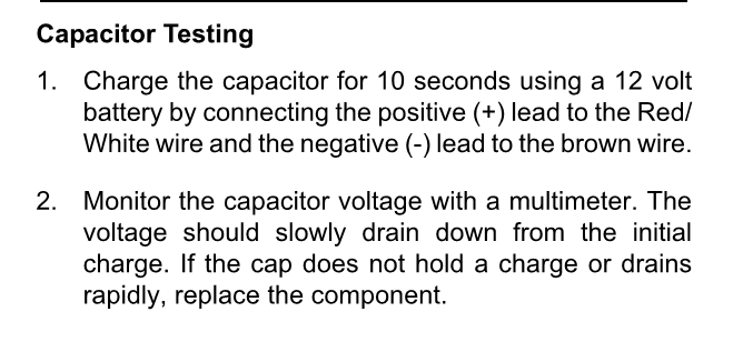

Thats odd, didnt think it would even start without the capacitor. Did you do the charge decay test on both the capacitors to make sure they are both good?
Not sure about that test so probably no I didnt. I cant find the second capacitor that is listed in the parts diagram, this is what looks to be a smaller capacitor just in the harness. Is there a capacitor in the hood harness? I will search the charge decay test and see what I get. thanks
Should it drain completely or hold some charge? Any idea where the other capacitor is located? Thanks for your help @850Switchback
It doesn't matter how much it drains, the rate it drains at is the important part. Should be pretty slow. If its quick or doesnt charge at all then its no good.

I tested the original, dropped maybe a .01 volt every 2 to 3 seconds so sounds ok??

That drop rate sounds good, so the capacitor isn't the problem. The 6v input however is no good, should be 12-14v. There is a open plug near the primary clutch marked "DC power", check for 12-14v at that plug. You might have to rev the motor off idle when checking to wake up the stator output.

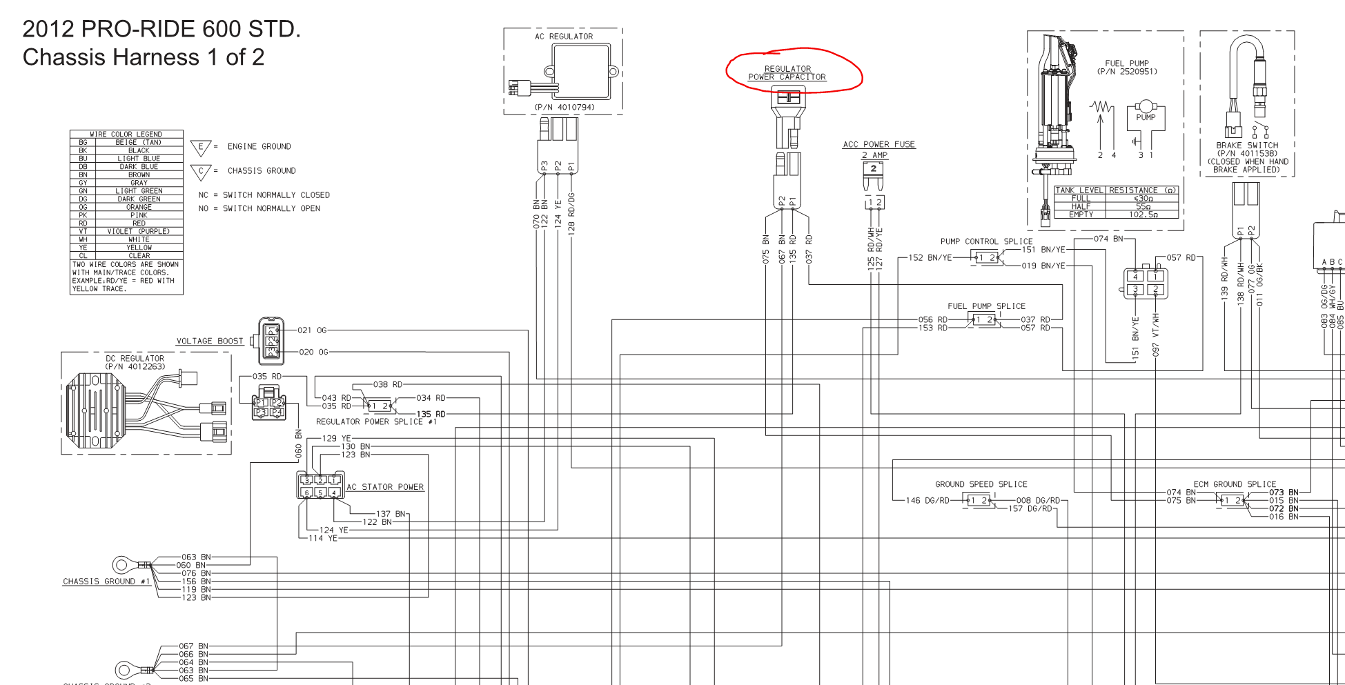

Yeah I'm out of ideas too other than chase out the capacitor wiring and see why its only getting 6v, The diagram below should help. Maybe something happened at one of the splices.
