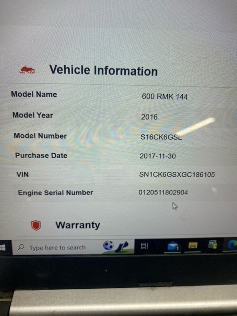

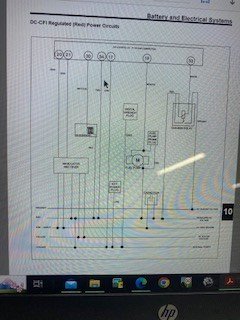

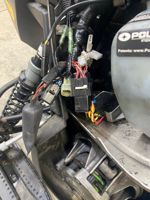

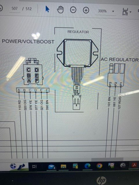

Yes you are right, I downloaded the 2015-17 AXYS, and Im more confused now then ever. hear why. First I ran the vin number to make sure I had a 2016. and yes it is.

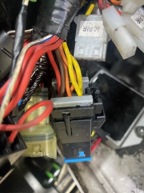

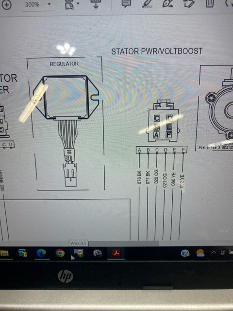

If you notice the wires going into the VR from the sled (3rd picture), you will notice that the two yellows are on top, the orange in the middle (which and connected to the yellows) and with have the Brown and red at the bottom. like the schematic on the right (2013 schematic). if you look at the 2nd picture (2016 schematic) , you will notice that is doesn't Match my wiring on the sled, I also do not see any other relays.

Ok I was wrong, this is where Polaris makes it confusing. That particular 144 RMK sled is still the old pro-ride chassis, so the first manual was the correct one. Does the service manual version you have cover up to the '16 models? The version I have stops at '13 and not sure if they made any changes after that.

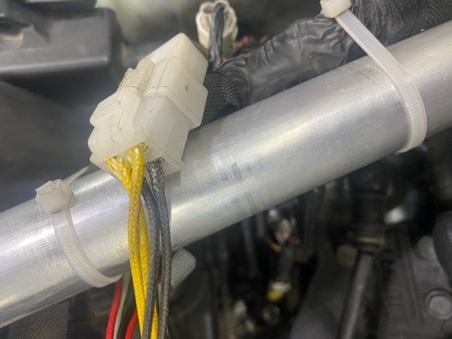

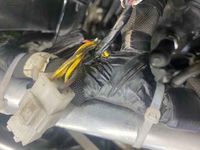

I notice the following at the connector from stator to VR
the two top yellows (1st pix) go into brown and yellow (books says it should go to yellows)
the two black bottom(2nd pix) go into the two yellows going to the VR (books says should go to the Brown and yellow)
Is this wrong or can the winding on Y and Z are the same and can be interchange ???
Doesn't look like in was played with
Tempted to switch them

Check the resistance of both those stator circuits, per the manual the Z circuit to the VR has the higher resistance value 0.2 Ohms ( more coils).
They unfortunately didn't give a good way to check the VR itself, the AXYS manual has diode checks you can perform on that VR but I havent seen it anywhere for the pro ride VR's .
Ya if you check above the reply, i did and its is a Little higher, i did switch the wire around as per the schematic, to my surprise it did start with cap and I had reverse, i shut it down try it again twice and worked, I then wrap the wires with cloth. put her back together and when to test her out outside. Didn't want to start again, same problem. needed to take the cap off to start and no rev. WTF, I put the meter on cap while running and I got 8vdc off the cap. raddle the wire and same. I don't know anymore
