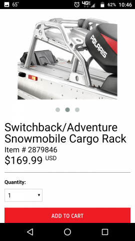

Polaris makes a very nice seat for the axys, but it works with the cargo rack on the rush type chassis.
Thinking about getting the seat and rack, and fabbing it to fit my sled.

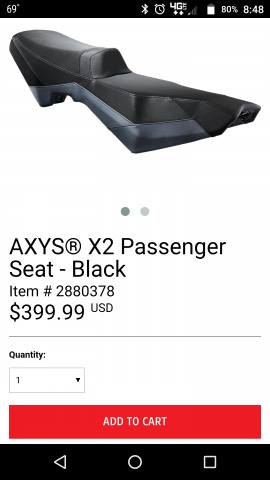

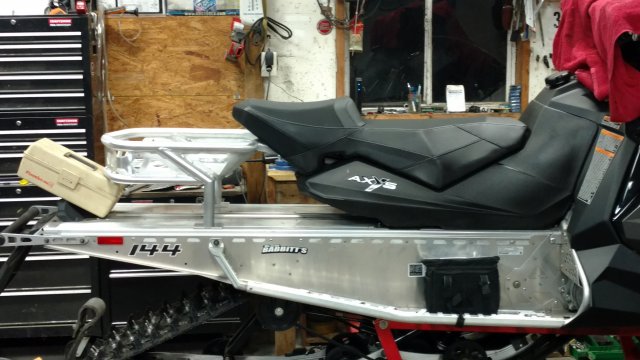

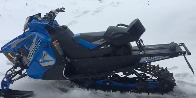

Well if anyone is interested, this is what I ended doing.
Cut the rush chassis rack to fit on my Assault.
Along with the X2 seat and backrest from Switchback adventure.
Looks good.
Having a 2 up setup is handy.
One ride take the wife, next ride shred it up with the guys.
Priceless.SmileyFaces7
Also can leave the rack on if I go on a long trip.
There's a few options of bags and such that'll lock into the rack.
Maybe better than a tunnel bag that gets wet, scratches tunnel, holds heat on top of coolers.
