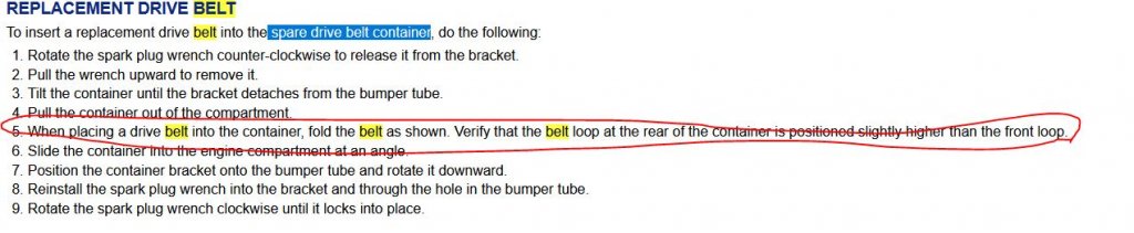

So in checking out my owners manual as to how/where to store a spare belt, came across the attached image about it. So #1-4, i can figure out..found the wrench and the belt holder already (have not tried removing it yet ..but fine). #5 is where the question is. they mention "fold the belt as shown". Shown where? what image seems to be left out of the manual. Anyone have a picture or series of pictures as to how to store that spare belt other than the documented-in-words version in the manual?

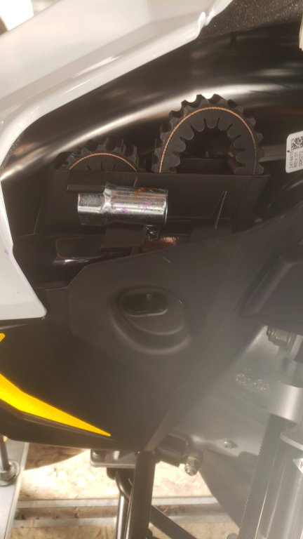

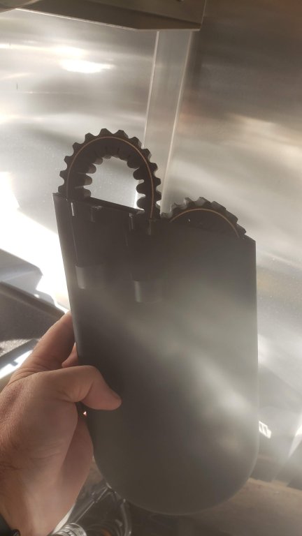

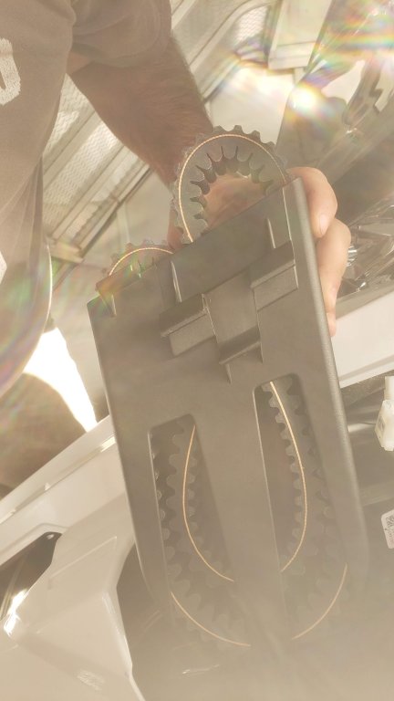

OK, fidgetted around ..a little..did not take much effort, and figured it out. for reference, those who have not looked yet, the holder for the belt is vertical under the hood inside the left side cowl. big and little loops are front to back referenced - such that the profile of the belt protruding from the pocket follows that of the hood.
Good info!! Can you post a picture?
yep here you go. First one is finished product obviously... middle one is from the "back" meaning the side that faces the engine and the 3rd is how it looks from outside the plastics.
That's the correct way according to Polaris. It's also listed in your owners manual should you have one.
