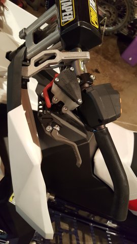

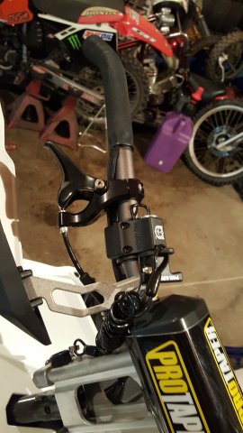

Installed a Munster finger throttle and sled solutions brake lever. Also built a quick disconnect sway bar and put the stock pipe back on until my Jaws heat shield shows up. That bottom spring is something else, I was ready to set the sled on fire. Lol
How does that finger throttle work with the TORS system ??
And is it heated ??
I have been flipping my throttle to the front for years, but the flipper is kinda bulky.
I like the looks of yours.
And is it heated ??
It is heated, they wired it wrong but I just pulled the pin and moved it over to the correct slot. They give you a plug with a jumper wire to remove the throttle safety switch. I wear a tether so I'm not to concerned about it.
