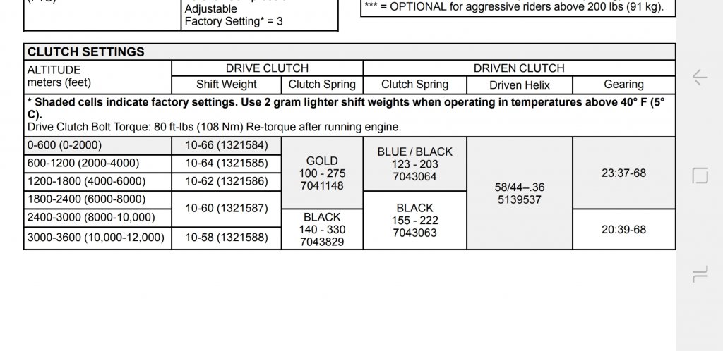

I have a 2016 Polaris SB Pro S 800 ES, where can I find the stock specs on my clutches and gearing?
IE primary and secondary spring colors and weights, helix angles, weights etc.
What I think I have found so far: 10-66 weights, 23-37 gears 1.61, 68 chain, so far so good or
am I off. Couldn't fine 1* or 2* spring weights or colors or helix specs. Thanks for the help
I think i found primary spring is gold, 100 - 275 and the driven clutch spring is blue/black and 123 - 203. Still no dice on the helix, and am not 100% sure on these spring specs.
Ok helix is 58/44 .36 all else is correct.
The 1.61 is for sleds with the ripsaw2 track, if it has the cobra it most likely is geared 1.68 (22/37)
Thank you Jesusfreak, that manual is what I was looking
for but could not find. JWB
