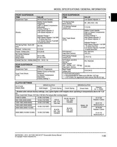

So Cory, you went from a 1.68 to a 1.73???
If you think you lost mph , can be numerous things.
Track tension is huge. 99% are running them way to tight and losing mph (Polaris specs). Warm track up on stand, check and make sure it hangs freely 1/2"
Chain tension: with parking break on. Move secondary back and forth . It should move 1/4" back and forth, but no more then 3/8".
You only need 0.100"-0.120" washer behind secondary and let it float out from there 0.120"
Belt deflection from Polaris specs is to loose. Adjust so track spins on stand but the belt doesn't squeal with sleds on ground
If you check all this and it's ok. Then it sounds like you have to much spring tension and not enough weight ?

Make sure that your belt isn't too long also. That will make you add more weight and the clutches won't fully shift out.
