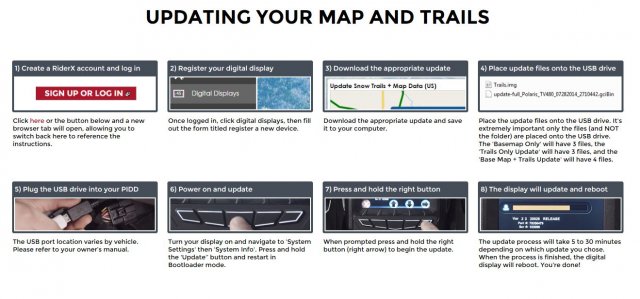

A new update was added too RiderX on march 5 2015 , too update fuel gauge update the IDD as normal !!
Tried downloading it but can't unzip the file. :mad:
I installed it and it took care of that flashing low fuel after only 50 miles.
On ride after updat I stopped for gas at 70.1 miles. Gauge read 70% and it only took 4.540 gallons.
Did 190 and never saw it flash all day.
I did it and it worked perfectly, so click on trails, download it, then once it's done. Open it and then you should have four files. So then click on one at a time and drag it to the thumb drive you have for the IDD gauge. Once one is done drag the other one and so on until all four are done. Then go put the thumb drive in your sled, then turn your sled on. Then follow prompts. If you have any questions let me know...
For those with the IDD gauge that have not done any Trails or Base Map updates. Pretty easy process.
