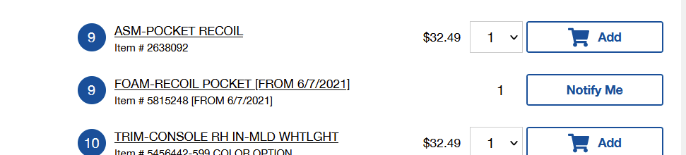

Saw someone posted a picture that Polaris glued a piece of foam above the handle on the 22s to stop the rattle.

Looks like it was built in July. Came to dealer without spindles and 7s gauge. Thanks for the update! Will ask the dealer about the foam.
Definitely, even shows on the parts diagram now.
