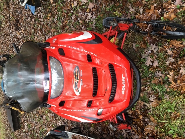

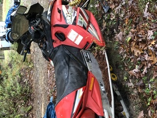

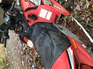

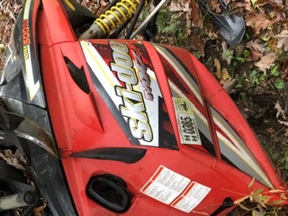

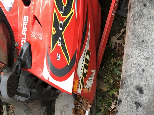

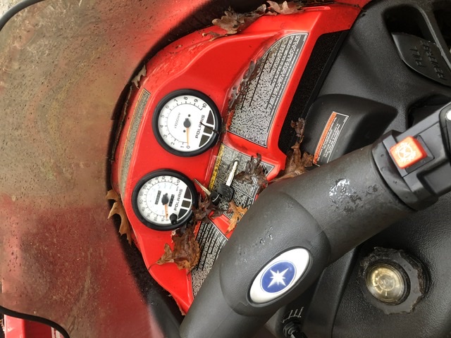

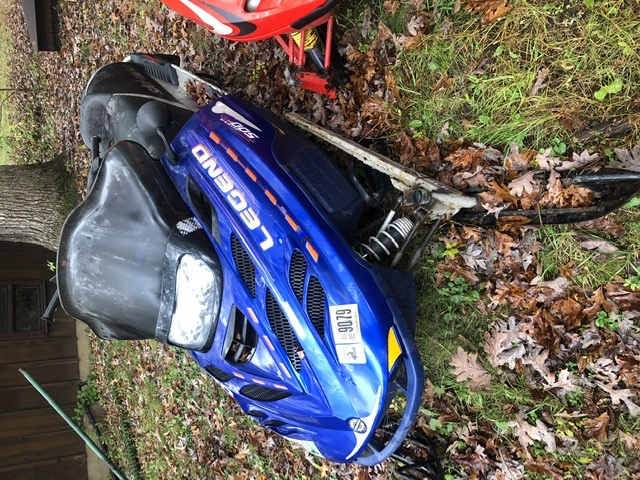

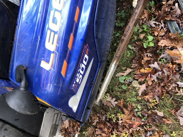

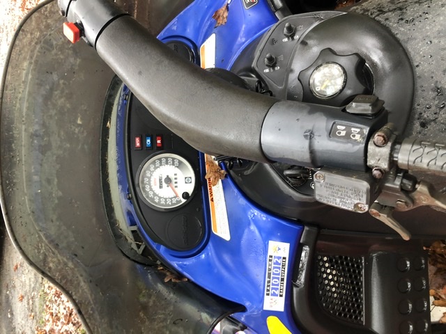

Okay guys I took some pics today. One of them is actually a ski doo. Looking for guidance on what these might be worth. The one is a Polaris X edge SP 700. And the other is a ski doo Legend rotax 500. Ski doo has 2000 miles
And Polaris has around 4400 miles. To mention one more thing, he also has a ski doo MXZ 500SS for sale for 1500. Wanted to see what would be the best deal. Thanks in advance.
Here’s the pics.

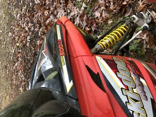

The $1500 one is here.

You mention he wanted $500 for the 2? The Doo for $1500 maybe if it runs.

No help on the ske du. The Polaris, is a 700 XCSP ves motor. Not a edge x. 700 motor is very good. Kind of the sweet spot for that year Polaris. Sitting outside can create a mulitude of issues. Seized bushing in suspension. Shock shafts rusted, bearings rusted in motor. No more than $1000 to purchase, and to be safe, a thousand in reserve to rebuild what is needed
