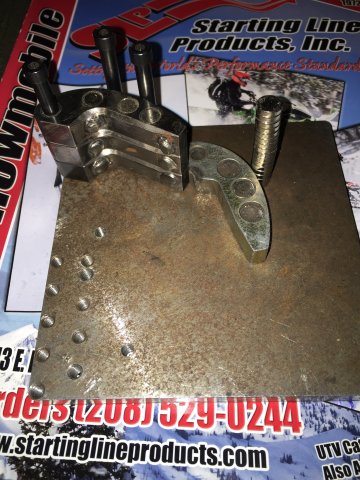

My dalton adjustables
Pictured are a set dalton pro's( non adjustables)
But I made them adjustable
I added .7 gram and .5 gram spot welds to heel and tip then drilled them out for magnets to be adjustable
They weigh a total of 71 grams with all magnets in it .
72 grams when I bought them
The profile is close to the same as 10 series and the heel too
I'm making epi belly buster weights adjustable now too
Except the base weight is 78 grams. More for the 800 ho power plant . So base will be around 66 grams drilled out and loaded with magnets will be around 76 grams
