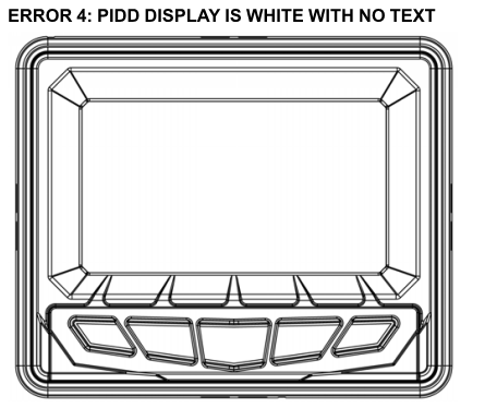

I have the nice GPS gauge on my 2015 60th anniversary Rush Pro S. Last weekend, half way thru a 100mile ride in about 0 degrees, the gauges went white like an old TV screen. So they are on and lit up, I can even see some of the detail if I look down at it from the edge but straight on, its like the brightness is so high its all just... white.

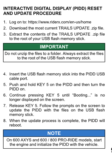

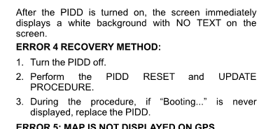

This is all I got, from the service manual
I talked to two dealers and neither heard of flashing the PIDD. I tried the reset but having tried the update w flash drive... I will try that but think "...replace PIDD" is the take away here :(.
