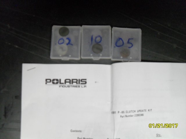

There are shims to put behind the spider buttons. I like to keep button clearance around .005. You can go tighter but heat soaking can cause binding.
The correct thickness on those button shim boxes should be .002 .005 .010

manual calls for .001 to .002 clearance between buttons and tower.I have .006 on mine and the clutch rattles,if I temperlaraly stick a .006 shim between the button and tower the rattling stops.I would go .002,you only shim the button on the trailing side.there is pressure on only 3 of the 6 buttons

Spider to tower, I like it no more then 0.004",and the same on all.
